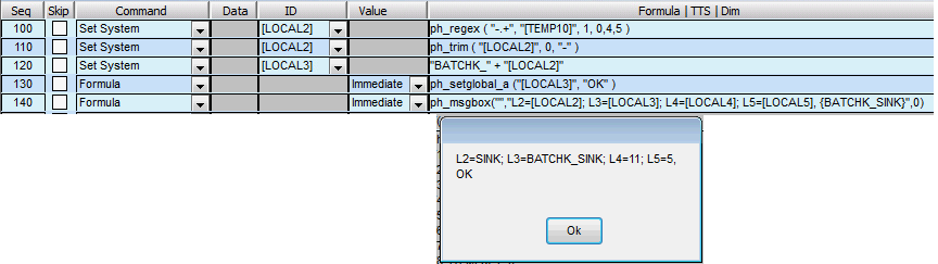

*** Simple Example ***
Assume you have multiple water leak sensors installed and trigger from each individually, but want to process them all with a single common Macro routine that puts the battery status (GOOD/BAD) in a series of Globals named "BATCHK_SINK", "BATCHK_WASHING", "BATCHK_TOILET"
The Leak Sensor battery periodic heartbeat Trigger will pass the triggering device's ID (eg, "WATER LEAK-SINK") to the Macro. If you name all the device ID's in a similar fashion, such as . . .
WATER LEAK-SINK
WATER LEAK-WASHING
WATER LEAK-TOILET
Then you can strip off the unique device name (following the dash) and write the status to the appropriate Global var, as follows.
The following string operations would find the unique device name then append it to the base Global string to form the unique Global variable name.
Macro line 100 searches the device ID string date passed in TEMP10 by the Trigger and looks for the dash character ("-") starting at position 1 in the string. Since this is a simple search no special Flag settings are needed, so "0" is used. The last two parameters will store in LOCAL 4 the position of the "-" in the string, and in LOCAL5 the length of the found data ("-SINK"). These are useful for further string operations, but actually not needed here, but shown for generality.
Macro line 110 trims the dash off the found string, leaving only "SINK"
Macro line 120 appends "SINK" to the common Global name of "BATCHK_" forming "BATCHK_SINK"
Finally in line 130, the value "OK" is written to this Global variable.
Line 140 prints out the various parameter values FYI.
