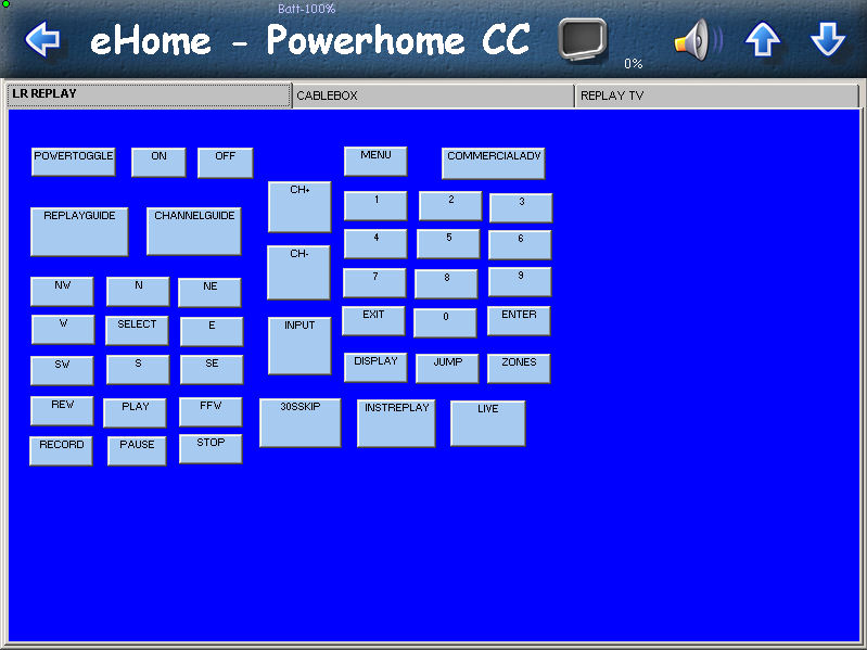

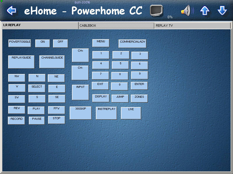

hhhhhhhhmmmmmmmmmmmmm.... Just playing. But its truly embedded into eHome. Its a child Window now...
Much better!!!!! I just love the Win API!!!
Again... Sorry Manny... Your my goto sample data guy...
Wish I had a way to change the TAB colors and frame color...

Congrats.
Rushed out of a meeting this morning when I got the email on my Treo.
At least by showing my ugly CC I know it's the real deal...
The embedded CC is good.
Now the question is
Will you be incorporating the UDP functionality in any other ways?
