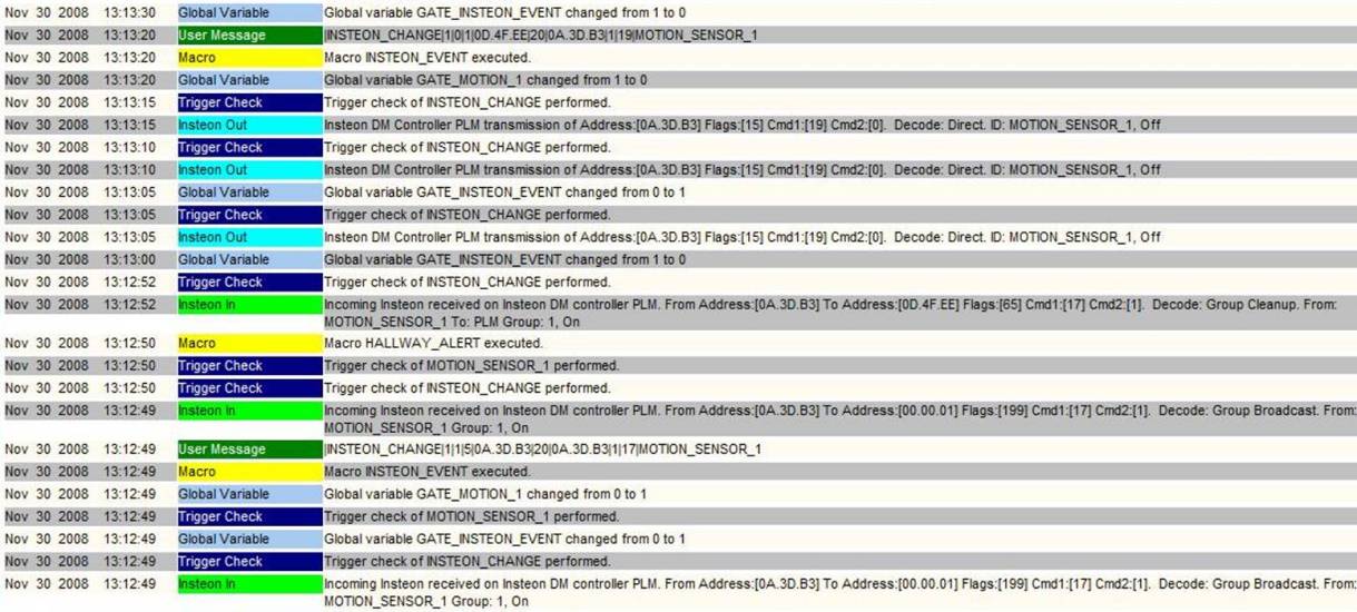

Another wrinkle, the motion detector is having problems with shaded red also. I’m get NAKs from what appears to be an OFF sent although it’s not coming from my macros. I do have jumper 4 on (ONs only sent no OFFs).
2008-11-30 13:12:49.578 RX RECEIVEINSTEONRAW=0A 3D B3 00 00 01 C7 11 01
2008-11-30 13:12:49.935 RX RECEIVEINSTEONRAW=0A 3D B3 00 00 01 C7 11 01
2008-11-30 13:12:52.837 RX RECEIVEINSTEONRAW=0A 3D B3 0D 4F EE 41 11 01
2008-11-30 13:13:05.305 TX 02 62 0A 3D B3 0F 13 00
2008-11-30 13:13:05.321 RX SENTINSTEON=0D 4F EE 0A 3D B3 0F 13 00 06
2008-11-30 13:13:09.328 RX INSTEON TIMEOUT=0A 3D B3
2008-11-30 13:13:10.306 TX 02 62 0A 3D B3 0F 13 00
2008-11-30 13:13:10.320 RX SENTINSTEON=0D 4F EE 0A 3D B3 0F 13 00 06
2008-11-30 13:13:14.322 RX INSTEON TIMEOUT=0A 3D B3
2008-11-30 13:13:15.307 TX 02 62 0A 3D B3 0F 13 00
2008-11-30 13:13:15.320 RX SENTINSTEON=0D 4F EE 0A 3D B3 0F 13 00 06
2008-11-30 13:13:19.328 RX INSTEON TIMEOUT=0A 3D B3

Posted: November 30 2008 at 15:38 | IP Logged
Pete, new thread with some specific symptom would not be a bad idea. There is a Group Broadcast, Group Cleanup Direct with an ON command from 0A.3D.B3 Group 1 (motion sensor motion ?). In response PH issues a Direct OFF command to 0A.3D.B3 which, if that is the motion sensor, would TIMEOUT as the RF receiver is sleeping.
Does the Event Log where detailed information is logged about messages received, triggers fired, macros invoked etc show anything around the 13:12:52 time frame when the Group Cleanup Direct was received. There is a 12.5 second time interval between when the Group Cleanup Direct is received and when PH sent the Direct OFF command. If the Direct OFF that PH sent was initiated from when the Group Broadcast was received, there is approx 15 seconds between it and the Direct OFF command.
Posted: November 30 2008 at 16:01 | IP Logged
Here’s the capture..
Posted: November 30 2008 at 16:23 | IP Logged
The event at 13:13:05 (Insteon Out) sent the Direct OFF to MOTION_SENSOR_1. There are three triggers that were fired, INSTEON_CHANGE, MOTION_SENSOR_1, and INSTEON_CHANGE a second time. Plus Macro HALLWAY_ALERT was invoked. Something in there directed PH to send the Direct OFF back to the motion sensor. Is it possible for the device ID for the Direct OFF command to come from a variable that was set to the MOTION_SENSOR_1 by mistake, either in one of the triggers or macro logic? Or maybe something PH sets as the result of an event which you then change to the device you want to use but PH set it back because of the sequence of in-bound messages. Just throwing out ideas without the benefit of seeing the triggers and macro.
Posted: November 30 2008 at 16:52 | IP Logged
The Insteon Change is from Insteon Device Change Any, Any, Any. It is used for my error recovery routines. The gates are used to control the amount of traffic triggers release if allowed. Hallway Alert is from the firing of the Motion Sensor 1 with Group In, 1 On and is gated from firing again on the second Group In. Hall Alert is nothing but a TTS and changes the global for the gate. Your right there was an Insteon Ioff issued by that macro ( ph_devicebtn(5,””motion_sensor_1”,ioff,”0”) It was intended for the purpose of setting the Motion Sensor to OFF in the Device Screen. My BAD!!! Thanks Lee as usual.
