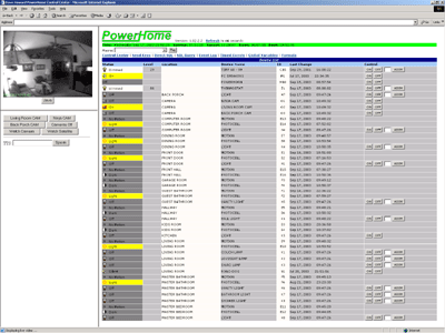

I think you can accomplish what you want to do using frames. This is what I have done at my home. Basically, I have 3 frames, the upper left is my camera, just below it are some quick buttons for camera control, and to the right of both of those is my main PowerHome screen. To accomplish this, I have a simple HTML which contains the framesets and this is in my web directory named index.htm. When hitting the internal web server without specifying a file, PowerHome will first check for an index.htm file, if none is found, then the internal main page is returned. If an index.htm file exists, then that is returned instead. The framesets are then loaded individually from this file and I have three separate web pages on one screen.

Below is my index.htm file:
<html> <head> <title>Dave Howard PowerHome Control Center</title> </head> <frameset cols="350,*"> <frameset rows="300,*"> <frame src= "javawebcam"><frame src= "></frameset> <frame src= ""></frameset> </html>
Not too different from yours. Below is a screenshot of what my webpage looks like:
