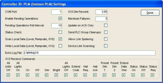

I have a PowerLinc Dual Band Serial Modem (Serial) 2413S Firmware Rev 1.5 - 1122.
I have the Device Type for the Modem set to 2412S - Powerlinc Modem Serial... PH doesn't have a 2413S... Should I have something else set?
I have notice that some of my group commands not all of the devices are changing state and a you have to send it again. My communication was almost %100 with my PLC.
Thanks for your input.
| Posted: August 29 2011 at 05:42 | IP Logged
The 2413 PLM is functionally equivalent to the 2412 PLM. The 2413 supports a smaller number of link records (1000+ versus 2000+). The Dual Band capability of the 2413 is completely automatic. There is no control over that capability nor any configuration. When the 2413 link records are loaded be sure to use the Add Full option.
Look at the PLC Controller definition and use the same PH2 options. Hard to suggest which options should be checked as it depends on how PH2 is used.
