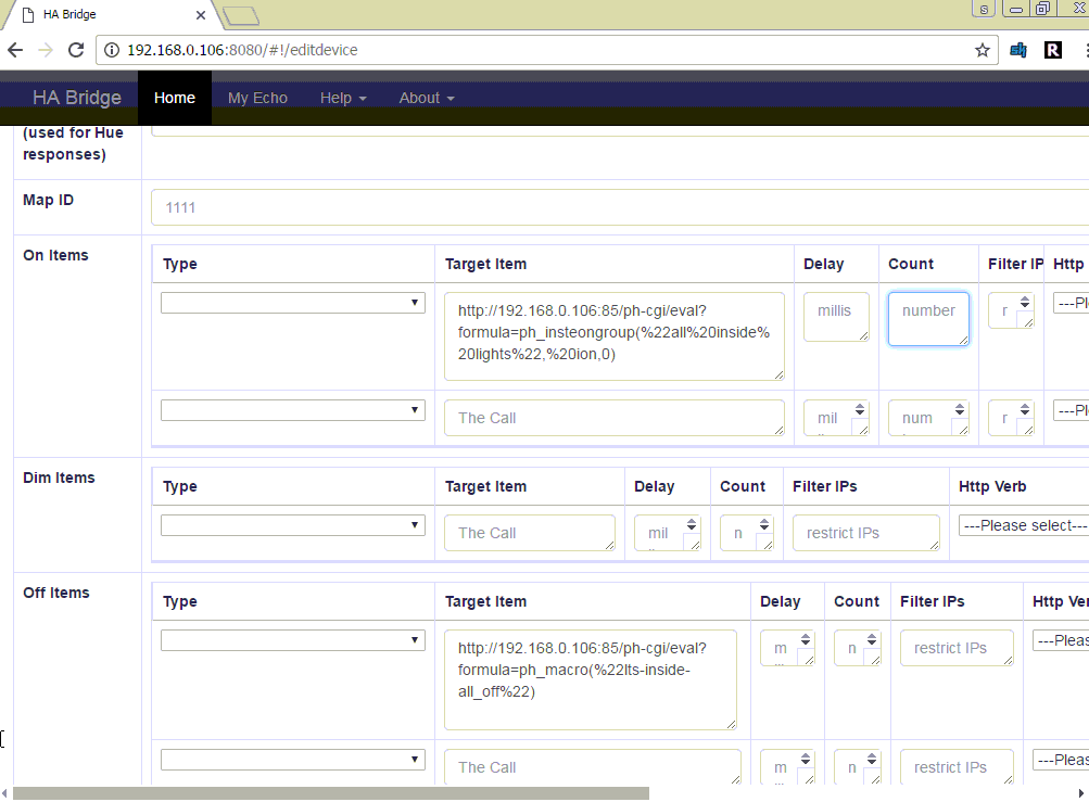

I thought I would share how I have combined the Amazon Echo voice service with PowerHome to have what I feel is a very slick integration.
My setup:
I have an Amazon Echo or Dot in most every room of my house. From most any location, I can say a command like “Alexa, turn on the kitchen lights” and it happens instantly and reliably.
How it is done:
On my local PowerHome machine, I run a Hue Bridge emulator (see https://github.com/bwssytems/ha-bridge). In the emulator, I set up and define the HTTP calls that get passed to the PowerHome web server that is running on the same machine.
I chose this approach for two reasons – speed and security.
The Amazon Alexa has all her smarts located up in the cloud. In my setup, the Alexa voice recognition service is the only network traffic that comes in and out of my local network environment (therefore, I use a strong Alexa account password). Once Alexa uses the cloud to figure out that I said “turn on the kitchen lights”, the rest of the process stays within my local network. In the Hue bridge emulator, I set up a device called “kitchen lights”. For on/off, I program in the proper HTTP calls that will get passed to the PH web server. Examples of on/off would look like this:
http://192.168.0.106:85/ph-cgi/eval?formula=ph_insteon(%22ki tchen%20lights%22,%2017,${intensity.byte})
http://192.168.0.106:85/ph-cgi/eval?formula=ph_insteongroup( %22kitchen%20lights%22,%20ioff,0)
Note that since this call comes from within my network, I use the local address (192.168.0.106) of my PH machine. My local address is a trusted IP address from within the PH web server. Note that I am running on port 85 because I have something else on port 80. Also note that this is not limited to just "on" or "off". Setting the “ intensity.byte” allows me to set the brightness to any value…so I could say something like “turn on the kitchen lights to 50%” or “set TV to 35%” (and it sets the TV volume).
When I “arm the house –away”, I trigger a PH macro that stops the Hue bridge emulator. That way all voice control is disabled. Upon disarming the house, I restart the Hue bridge emulator and voice control is seamlessly restored (you don’t want someone standing outside your house and yelling “turn off house alarm”).
I presently have over 50 devices set up in my Hue bridge emulator. I have lights, TV, TV volume, garage doors, etc, etc, all set up using voice control. If PH can control it, it can be set up in the Hue bridge.

Great - I have not fully configured yet , but I think voice
command are limited to ON, OFF and DIM/BRIGHT.
can you please post the picture of add device of yours from
ha bridge , of course block your personal info.
Thanks

Once the .jar file is running on your local machine, the Hue Bridge emulator (see https://github.com/bwssytems/ha-bridge) can seen by opening your browser to your local IP address to port 8080 (8080 is the bridge default). Note - IE11 doesn't display the bridge properly for me,...I had to use Chrome instead.
Starting with version 4 of the bridge, the format of the "Target Item" type boxes has changed to expandable/"drag the lower right corner" type boxes (so you can see all of your HTTP call). Please take a look at some of the "closed issues" asking about how this new display format works. It caused questions for many of us that were used to seeing the older display style of the bridge.

Thank you -
Also found that url coding need to use JavaScript
encode, meaning you cant use ph_macro("kitchen_lt_on")
but ph_macro(%22kitchen_lt_on%22). where 22 is Hex for
double quotation in Ascii.
yes in ver 4. its was tricky to add url in Target
item. Thank you again.
I had used IFTT where you can use more verbiage but
again not a big fan of lowering security.
Nick
