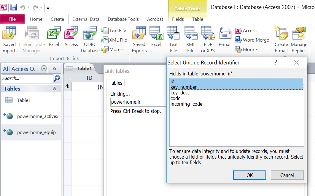

Launch Access. Create a new blank database:
With your new blank database opened, click on the "External Data" menu and choose "Link to the data source by creating a linked table.":
Select your newly created ODBC entry for PowerHome:
Select the PowerHome table(s) that you wish to link to Access:
Select the primary keys for each of the tables you selected. Typically this will always be at least the first column:
After you've selected your linked tables, you can then right click and Open them to view and manipulate the data:

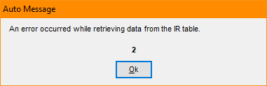

They are BOTH totally empty, yet I'm still getting the IR Error on Startup.

I took a look through the code and that error message is only produced by an Infrared capable controller or by making a call to an infrared command (ph_ir
function or similar or an IR call from a macro). Nothing in normal PowerHome startup would be attempting to read from the IR table. You would not get this
error as a result of database corruption.
The error is indicative of trying to read data from the IR table. I would check your startup trigger to see what is being called. I would also do a
database search for %ph_ir% to try and locate where you may be calling an IR function.

Look at what I found as the last entry in the PH Initialize macro...
That was it and everything works OK now! This error has been bugging me for over a year. What a relief to finally get rid of it.
