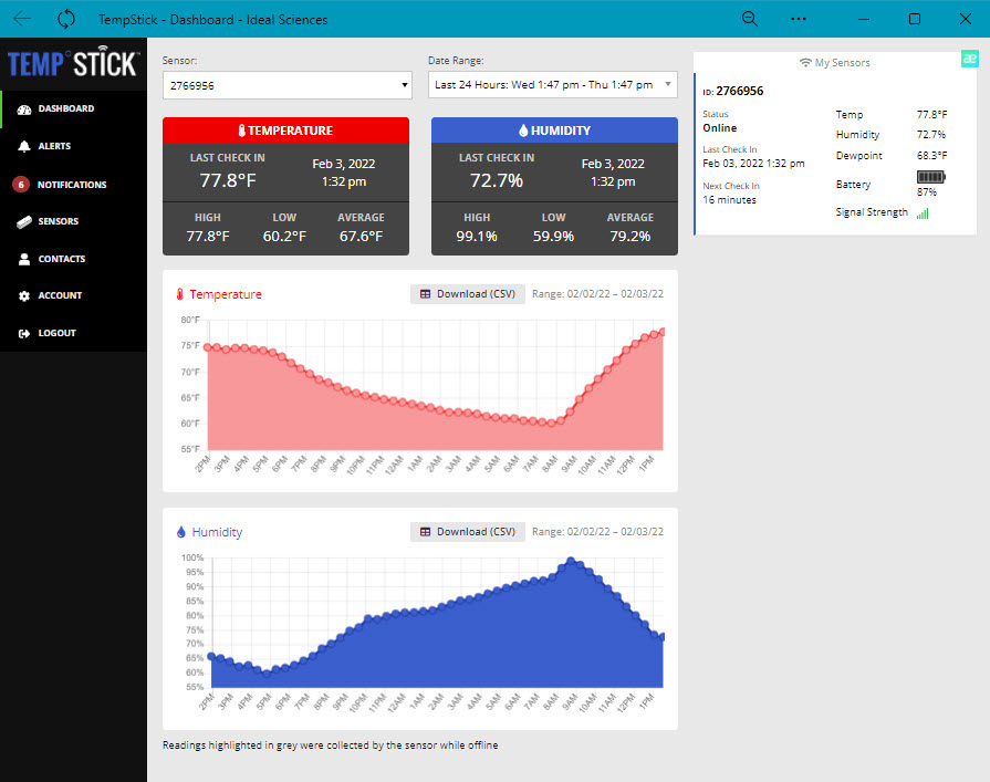

For several years I have been fetching my outside temps from my TempStick (https://tempstick.com/) which produced a (normal) web page with text and html formatting.
But months ago they changed the site from a 50,000 character site to a 400 character site by creating a single Home page comprised of almost nothing but links.
While the link collection produces a viewable web page the ph_geturl1() function sees nothing and I am unable to thus extract any meaningful temp data.
Is there a PH URL function or configuration of one that will process the raw page into the user viewable form see when you access it as a web page which looks like this...
Any ideas of how I can regain this weather page feed?

Likely what has happened is that they've updated the site to pull various portions back in iframes or similar. Whenever you hit a webpage, the HTTP
is retrieved which can potentially include links to images, javascript, iframes, cascading style sheets, etc. A standard browser will interpret the
initial HTTP, scan it for these other links and sequentially pull those other URL's and render them in the browser window.
Im not certain of the exact URL you are using but the actual data you're interested (probably sensor data) should be in one of the links that is
coming from the main URL. If you could send me the actual 400 byte return data from the ph_geturl1 function, I may be able to determine something
else for you to query on.
An option you can try is using the ph_getwburl function. This function uses the (now ancient) Internet Explorer web browser control to pull the sql.
Theoretically, it should be able to pull down the full HTML that is used to render the page since it's an actual web browser. The only problem I see
is that it is likely too old to understand the newer HTTP protocol so may not work properly. The newest versions of PowerBuilder (the language
PowerHome is developed in) include a new, updated Chromium web browser control that I plan to implement which may end up providing a solution (no
timeframe available on when I'll have that ready though).
Anyways, if you can post the 400 byte return of ph_geturl1, I should be able to determine a possible solution for you.

Thanks Dave -
Please find attached a scrape via URL1 and an image of what appears on my computer screen via MS Edge browser. Note the two captures where taken a few minutes apart so specific variable values may not match.
2022-02-03_130158_wthrStik - URL1 Scrape.txt
