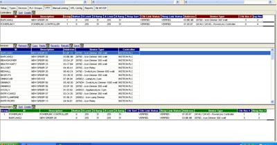

I still cant figure the right pane thing
See attached image.
Can anyone help - I keep trying to grab a handle on the right but does not work. Tried maximizing screen etc....

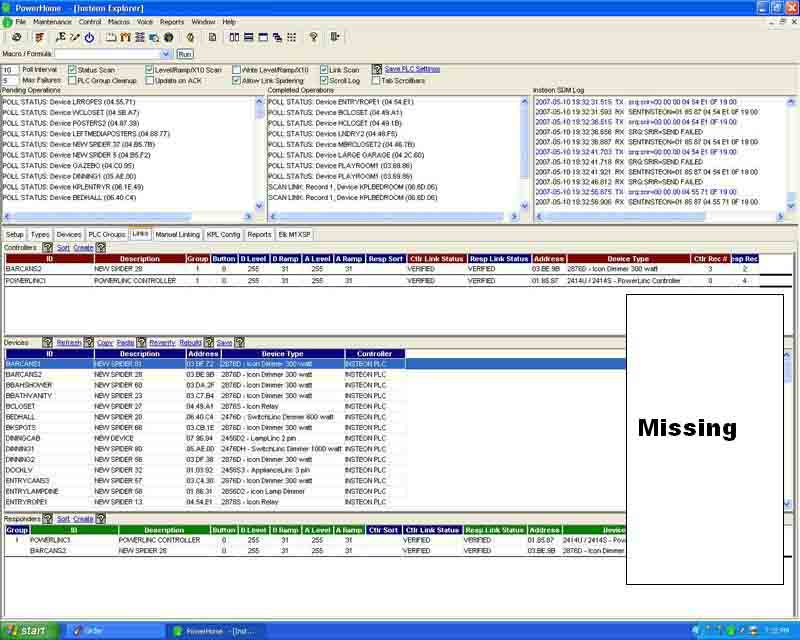

Here
I hope this is better. Either way if you open insteon explorer on 'your side' you should see an area on the right that lists all the devices that then allows you to use the 'left' or 'right' arrows to assign them to the controller or responder areas.
Mine has gone away.
I DREW A BOX WHERE IT SHOULD BE labeled ' Missing'

See the vertical grey line/bar on the very edge of the right side? That looks like the splitter bar. See if you can grab that with the mouse and drag it to the left. I wasn't able to get the splitter bar over that far on my system.
If that's not it, then Dave will have to chime in. I took a look at the ini file to see if I could see something that looks like the Insteon window settings but nothing jumped out at me. They may be stored in the database.

Yes I see the grey bar and I have tried many times to grab it, click it, move it, etc. No luck..........
Dave (or anyone) any help?

OK - I was able to get the Device window back by un installing and re-installing the software.
Thanks
Posted: May 19 2007 at 22:18 | IP Logged
Arghhhh!!!! I arrived too late.
Sorry Frank that you had to reinstall to fix this. I dont know how it got so far to the right as PowerHome tries to prevent this from happening. If it should happen again, the location of the splitter bars is stored in the pwrhome.ini file. To fix this, just open the file in notepad and navigate to the [Insteon Explorer] section. Next, locate the parameter "linksv1". Set this parameter to a lower value such as 1000 and save the file (do all this with the Insteon Explorer currently closed). Open the Insteon Explorer and the splitter bar should be visible and able to be resized appropriately.
