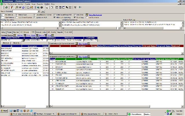

Thanks again Tony. I linked the switches to the controller as you mentioned. It looks like the links were created successfully. Here is a screen shot of my Links tab now:
But, I'm still not seeing anything in the logs when I press the SwitchLincs on/off. I can still control them through PowerHome, but it makes triggers pretty useless.

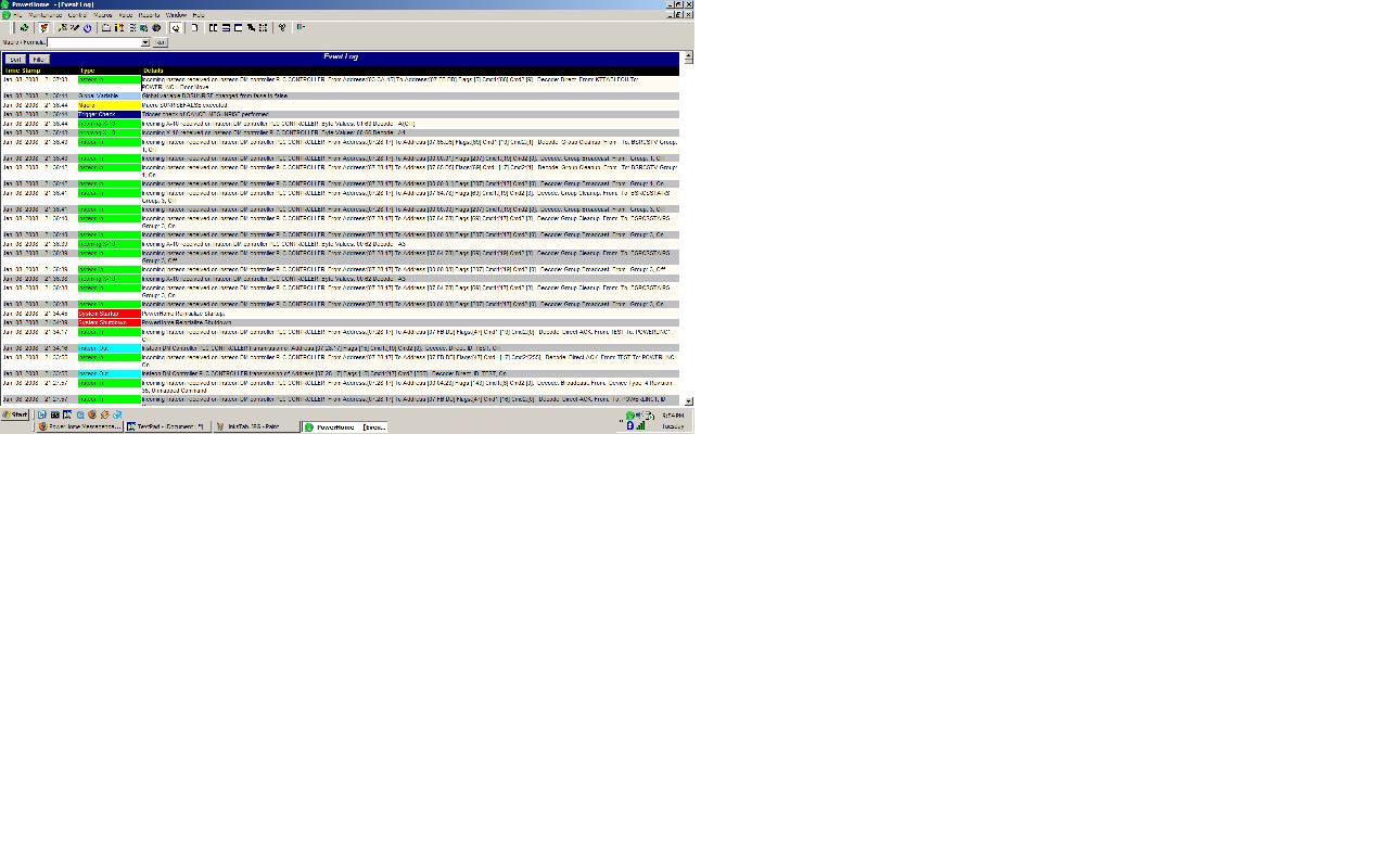

One thing I did notice - I have a ControlLinc setup to control 3 of the lights. When I use the ControlLinc, I see a message in the logs. Here is the latest from my logs:

Posted: January 08 2008 at 22:44 | IP Logged
Can you repost the pics? I can't make anything out.
If you have your PLC selected in the first one, the links need to be on top.

Sorry about the terrible pics, I was hoping they would show up better after adjusting the size.
I finally noticed what my problem was though, mostly due to your comment about the links being in the top section. On the Links tab, I had all of my devices listed as Responders to the PLC instead of Controllers. Guess my thinking was that the switches were normally be responding to the PLC when PH sent commands. But it makes sense that they need to be set as controllers since they are sending messages to the PLC as well.
Thanks again for your help. The events are being posted to the log now, and I was able to setup a trigger successfully.
cmhardwick Senior Member
Joined: July 08 2006 Location: United States
Online Status: Offline Posts: 290
Posted: January 09 2008 at 08:44 | IP Logged
mcable1004, they are in both sections normally. They are responders and controllers.

Posted: January 15 2008 at 15:34 | IP Logged
A common misconception that alot of people make. When PowerHome directly controls an Insteon device, it is doing so using a "direct" command and so works without any links needing to be created. The PLC is about the *only* device that I know that uses this type of Insteon command. Devices themselves such as switchlincs and keypadlincs all communicate with "group" commands (which require links). When a switchlinc is manually controlled, it will attempt to send a group command (if it is linked as a "controller" of another device). If the switchlinc isnt linked to another device as a controller, no Insteon command is generated. If the switchlinc isnt meant to be a controller of any other device, a common technique is to just set it as a controller of the PLC itself. Since it now has a "controller" link, it will send a command when it is switched.
