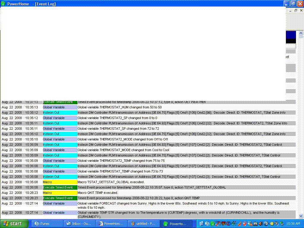

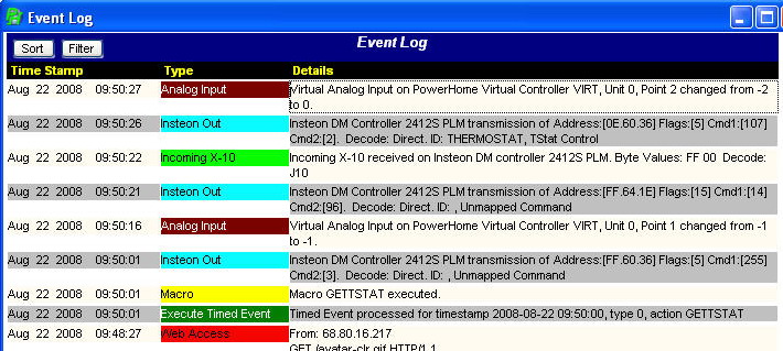

Then I noticed that I had the following Event Log capture
The Macro GETSTAT should have been quering the Thermostat with the three Insteon Out commands sent, but the first two are logged as "Unmapped Command". Also, between the last bad command and a valid "TStat Control" command is a bogus "J10" X10 signal.
Bottom line. It looks to me like I may have a bad PLM (which is just a week old so I have no history with it, except that things have never worked right as far as I was concerned right from the get go).
Anyone have any thoughts?

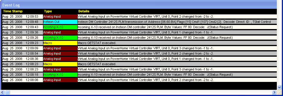

Posted: August 22 2008 at 12:34 | IP Logged Quote GadgetGuy
Nadler -
I am using Dave's Virtual Analog Device macros which do not populate the Global Variables.
When things go well my STAT inquiry transmissions all look similar to the 09:50:26 Insteon Out transmission in my image above.
It was just the several occurances of strangness before it that I noticed while debugging the noise stream. That strangness is not common but seemed to me to be a possible symptom of PLM malfunction that explained the bogus streams of "J Status" and "M13 On/Off" commands, etc I have been seeing.
Sometimes this bogus traffic is so bad that my lights won't reliably work as they can't sneak a "valid" communication string into the too busy com-stream!

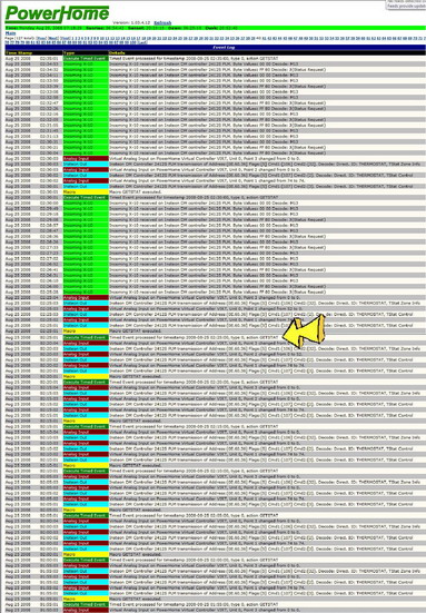

After several days of experimentation and watching the power line with an oscilloscope it seems pretty clear to me that the rogue command streams I am seeing are not random but are being generated by one of my Insteon devices.
Using PH I have cleared all X10 addresses out of all Insteon devices. I have no X10 devices connected anywhere now. In other words I now have a pure Insteon network. I do not have not checked any of X10 status/ramp/level boxes in PH to stop it looking for them.
Every time a rogue command sequence appears I can clearly see it on the scope with a little over a 3v peak-to-peak signal at ~130KHZ appearing at the zero crossings. My electrical lines are amazingly clean, but then we live in the country and the closest neighbor is about 1/2 mile away, so the only noise should be what we create in our own home (and there sure shouldn’t be much because I have a small fortune in noise filters on every PC, TV, and other significant electronics device!)
The rogue command sequences appear to always be triggered right after a GETSTAT query. It does not happen every time but comes and goes in long periods. For instance, last night things worked OK until 02:25:01AM [below yellow arrow]. As can be seen, before that time the STAT was queried every 5 minutes without incident.
Then the problems begin [above arrow]and continue all night long with 23-27 "X10 J{Status}" rogue requests appearing after EVERY GETSTAT sequence until my DAWN macro executed just after 7AM.
At 07:14:44AM when my DAWN macro executed [yellow arrow] the subsequent GETSTAT macros have run (now for over an hour as I write this) without any rogue sequences. The DAWN macro just turns off various night lights around the hose and resets KPL keypads back to a cleared state to make sure the button lights are back in sync with the lights they control. I do note that my downstairs KPL has the highest NAK count of any of my network devices. Could it be a "sicky"?
A past experiment was to disconnect my Insteon STAT module and it did not stop the rogue sequences. Given the positive rogue signalling seen on the oscilloscope it just seems that I have to have a Insteon device gone wild somewhere.
Something appears clearly tied to the execution of GETSTAT macro and gets confused or cleared up by commands sent by other macros.
