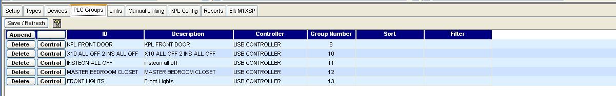

When i go to change the group number and save it, it says it "must be between 1 and 1". Under the group tab i have three groups (8,9,10).

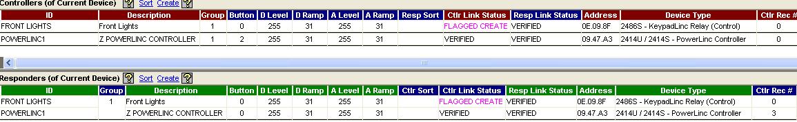

| Posted: June 02 2009 at 07:26 | IP Logged
So if you want PH to be able to see if the status of the light switch is on or off (switched on at the actual keypad or light switch) you have to click the insteon device you are dealing with, drag the plc/plm to the responder secton and drag the switch to the controler section. Select the group # and button #.
Can you put the plc/plm in the controller section AND in the responder section and the light in both as well. That way they communicate both ways?
This is a shot of my screen.
IT does not say verified.
| Posted: June 02 2009 at 09:24 | IP Logged
Flagged Create indicates the link has not been written yet and therefore is not functional. The screen capture does not show the currently selected device so I cannot tell what links are being defined between what devices. You double click on one of the devices in the list and that makes it the selected device. The blue columns in both the Controllers section and the Responders section refer to the currently selected device. The reddish brown columns in the Controllers section refer to the device(s) that are being linked as Controllers of the current device. The green columns in the Responders section refer to the device(s) that are being linked as Responders to the current device.
As an example, select SwitchLinc A as the currently selected device. The blue columns in the Controllers and Responders sections all refer to SwitchLinc A. To link the PLC as a responder to SwitchLinc A, drag/drop the PLC to the Responders section. The blue Group column in the Responders section must be 1 as SwitchLinc A only has one group and that is Group 1. To link the PLC as a controller of SwitchLinc A, drag/drop the PLC to the Controllers section. The reddish brown Group column refers the group number the PLC will use as the Controller. Unlike a SwitchLinc where the hardware is hardwired to use Group 1, the PLC can use any group number from 1 to 254. As though the PLC had 254 virtual paddles and you get to pick which one. It is important not to use the same group number in the PLC controller definition for different scenes. You can use the same group number for a collection of responders that should respond to the same group. Just like you can link multiple responders to SwitchLinc A group 1 and those multiple responders all respond to the SwitchLinc A paddle press.
When the drag/drop definition information is complete, click on Save which will cause PH to schedule the creation of the link records. The links must say “verified” in both columns to be active.
There is one more step needed to use the PLC as a controller of a device(s). Under the PLC/PLM Groups tab you define the ID you will use for the device(s) being controlled by the PLC group. Set the ID to something meaningful to you and set the Group number to the group number you picked when you drag/dropped the PLC as a controller of SwitchLinc A. Now you can issue Group commands using PH functions using the ID just defined. PH will send a Group message sequence using the Group number associated with ID, and any device that was linked to the PLC as a responder and using group number will respond.

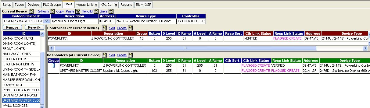

| Posted: June 07 2009 at 20:33 | IP Logged
Sorry its taken a few days to post this...
Still says flagged created.
| Posted: June 07 2009 at 21:05 | IP Logged
The second link definition under Responders (of Current Device) is itself. You cannot define UPSTAIRS MASTER CLOSET as a Responder of itself. What are you trying to accomplish making the SwitchLinc a responder of itself. You need to drag/drop this link definition to the Remove button.
The other columns that are marked "Flagged Create" are both link records to be written in the SwitchLinc. Since neither is written either the SwitchLinc Devices "Clear Failed" column is shaded red (in which case you need to put a check in that column for the SwitchLinc or the SwitchLinc is checked Disabled, or the "Enable Pending" option in the upper left corner of the Insteon Explorer screen is not checked, or a combination of the above.

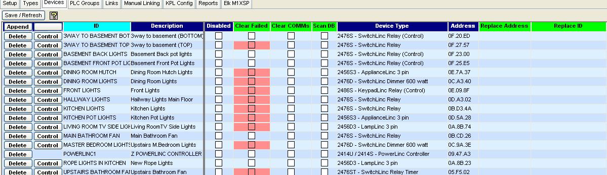

You are correct... but why are these all red under the "clear failed"
So if you see these red, check them off and hit save right away?
Do you want to define it as a "controller" of itself?
Should you have the plc/plm as both as well
Edited by funbobbybaby69 - June 07 2009 at 21:33
| Posted: June 07 2009 at 21:31 | IP Logged
If they all happen at the same time the PLC controller may be hanging up. If you cannot communicate with these devices now it may be necessary to unplug the PLC, waiting for 30 seconds or so, and then plug the device back in. You could be having a USB problem if the PLC is connected using USB. If the devices are being shaded at different times, in general one at a time, then you are more likely looking at a powerline reliability issue. You may need a FilterLinc on the PC/UPS so that the power supplies in these devices do not attenuate the Insteon signals, making communication unreliable. You may need Access Points, or they may not be installed on opposite 120V legs. Powerline reliability is topic unto itself.

| Posted: June 07 2009 at 21:40 | IP Logged
Are any of these not checked that should be?
