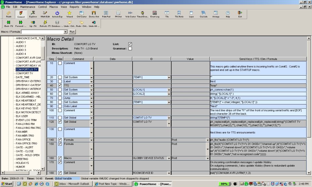

Since I have other RS-232 controlled devices, I tried using the same approach ...see lines 30-90 of the picture below.
Note: This is just an example macro (this is how I control my LG TV).
This approach does NOT seem to work.

The mount is using binary, so you can just switch your ph_comrecvchar(1) to a ph_comrecvstring( 1, 1 ).

...and, of course, get rid of the CHAR( INTEGER()) bit as these will not translate to ASCII. That should be...
Set System [TEMP1] "[TEMP1]" + "[LOCAL1]"
After the string is built, you can compare to your encoded responses, just in decimal not hex ("\xAD" would come in as "\173").
